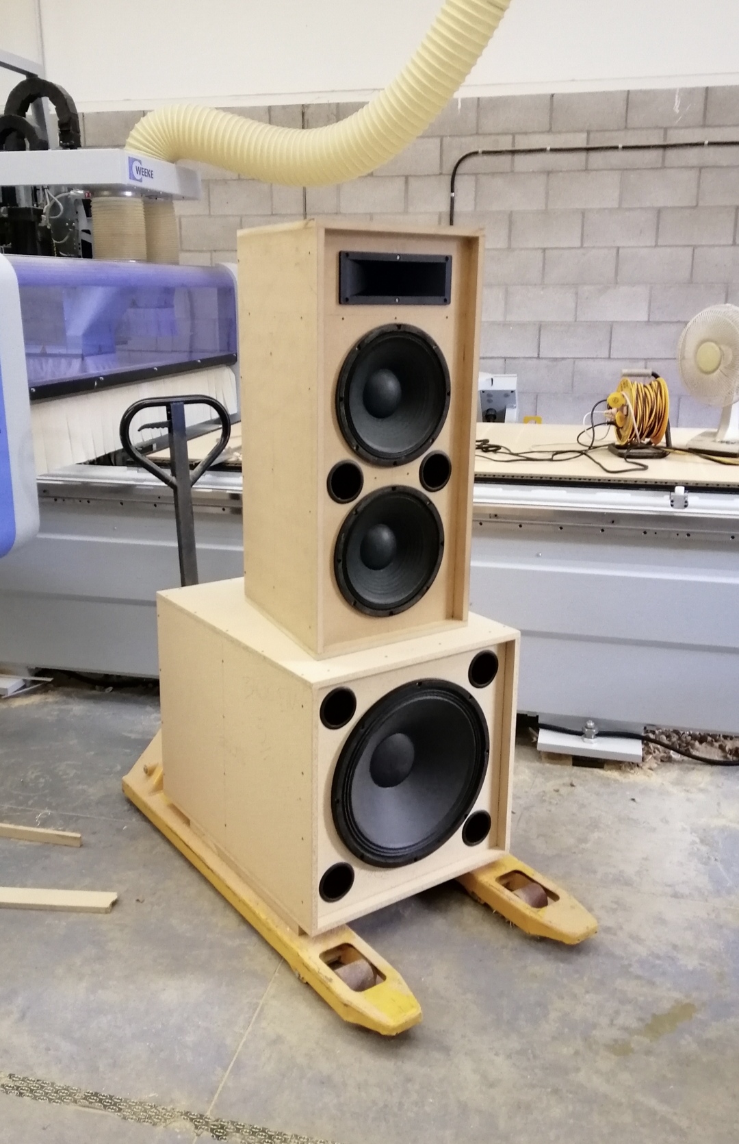

This is my demo sub with my twin 12" on top. Sub is 16mm particle board but will change to 18mm mixed hardwood plywood before the first event. call this sub "Harda Audio B18-500" and the top "Harda Audio T12D-400"
Screenshot_20190108_223735.jpg [ 499.59 KiB | Vizualizat de 4041 ori ]
I will be using 2x twin 12s and 4x single 18 for the party in one month. Hope it will be enough for 100-200 people.
