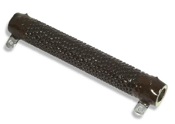

am gasit aceste rez de putere mai mare
C300K3R1.jpg [ 21.01 KiB | Vizualizat de 1974 ori ]
am sa iau 4
2 de 4 ohm
2 de 8 ohm
sau toate lafel si asa cum le combinam tot puterile alea sant
mam gandit la asa ceva:
|<----R4------<|>----R4------>||<----R4------<|>----R4------>|
16 ohm 1200W
|<----R4------<|>----R4------>||<----R4------>|
12 ohm 900W
8 ohm 600W
|<----R4------>|
(--------------)|<----R4------>|
|<----R4------>|
6 ohm 300W
4 ohm 1200W
|<----R4------>|
|<----R4------>|
2 ohm 600W
|<----R4------>|
|<----R4------>|
|<----R4------>|
|<----R4------>|
1 ohm 1200W
cu ceva intrerupatoare care le pun sum vreu au
