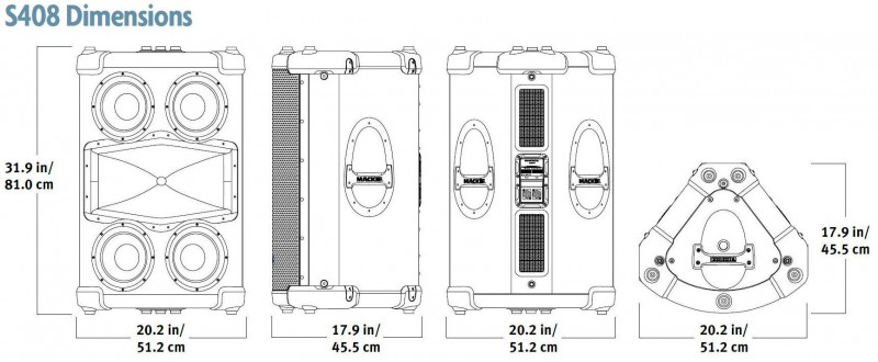

Aici aveti un exemplu asemanator cu proiectul meu , dar de la Mackie :
Mackie S408 Precision Passive 2-Way Loudspeaker Specifications:
Frequency Range ( 10 dB): 60 Hz 22 kHz
Frequency Response ( 3 dB): 80 Hz 18 kHz
Sound Dispersion: 75°x40°
Maximum SPL Long-term @ 1m: 127 dB
Sensitivity (1W/1m): 99 dB SPL
Crossover Frequency: 2700Hz
Input Protection: Dynamic protection for compression driver
Basic Design: Trapezoidal
Material: 18 mm multi-layered plywood, resin end caps
Finish: Wear-resistant textured black PVC vinyl
Handles: One on each side, one top, one bottom
Grille: Perforated metal with weather-resistant coating
Dimensions (H x W x D): 31" x 20.1" x 17.9"
Weight: 72 lbs.
Mackie S408 Precision Passive 2-Way Loudspeaker Features:
4 x 8" LF drivers in unique Tetrad alignment offer wide low-frequency dispersion and enhanced transient response
1" exit HF driver on an oversized 75 x 40ø horn provides superb coverage and high-frequency definition; 2 vertically arrayed enclosures provide 150ø coverage
Pole mountable on commercially available speaker stands
Symmetrical Trapezoidal design allows for monitor wedge applications
Stackable atop S410s Precision Passive Subwoofer
Flyable both horizontally and vertically via 12 integrated 3/8" threaded inserts
Portable with 4 balance-optimized top and side-mounted handles
Dual parallel, locking NL4 connections for Input and Thru on rear panel
Thermal Overload HF driver protection
Sensitivity: 99dB SPL (1W/1m)
600W RMS power handling at 8 Ohms
Frequency Response: 60Hz-22kHz
Avantajele solutiei 4x8" +1" sunt descrise aici :
HOW TETRAD WORKS
In a typical 15", 2-way loudspeaker system, the 15" audio speaker offers relatively slow transient response, and the small high-frequency horn tends to beam a narrow, blaring sound at the listener—end result, muddy sound. By replacing the 15" speaker with four 8" drivers (that's what tetra means, four), Mackie increased the driver surface area to 201 sq. inches from 177 sq. inches, creating more punch and a tight, more focused low-end. It's hard to believe, but four 8" transducers offer better transient response and move a bigger column of air than a single fifteen.
VOCAL CLARITY AND PATTERN CONTROL
By using four 8" low-frequency drivers, Mackie was able to drop an extremely large horn into the S408 speaker and still keep the cabinet size small. Besides presenting a more friendly load impedance, a bigger horn yields lower distortion, better pattern control and allows the horn to operate more efficiently at lower frequencies all the way down to the heart of the critical vocal and midrange zones. Since this larger horn is more stable through the crossover point, the transition to the LF drivers is virtually seamless, in terms of frequency response and directivity. All this adds up to greater consistency throughout the entire coverage pattern, resulting in vastly improved intelligibility across your entire audience.
POWER HANDLING
Due to its extremely efficient design, the S408 can be driven by even the smallest of power amplifiers. But to showcase its full potential, strap-on your beefiest amp (maybe one of our M-Series High-Efficiency Power Amps) and climb to a new level of sound quality and professional capability. The S408 is, quite possibly, the closest thing to "concert-quality" sound on the market in its class.
VERSATILITY
Designed for maximum versatility, the S408 speaker can be stacked, or pole-mounted, on the S410s Subwoofer. It can also be flown via 12 integrated rigging points, either vertically or horizontally. They function extremely well when arrayed in pairs, providing outstanding coverage to an incredible 150 degrees. And the S408's trapezoidal shape makes it perfect for use as a floor monitor.
Cateva imagini si manualul de utilizare :
Mackie S408 image.jpg [ 160.66 KiB | Vizualizat de 3058 ori ]
Mackie S408_OM.pdf [928.8 KiB]
