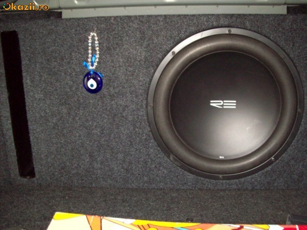

pai zimi si mie ce amplificator trebuie sa folosesc la un woofer "RE" SX 15 DE 2000W?

bogdan. scrie:
pai zi-mi si mie ce amplificator trebuie sa folosesc la un woofer "RE" SX 15 DE 2000W
hai ca ti-am corectat eu tura asta. Da-mi un link cu wooferul.

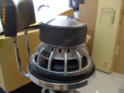

Membru din: Mie Ian 05, 2011 2:55 pm
Mesaje: 14
Sizes: 15" ( Dual 4 ohm)
• Dual Composite 2-piece Cone
• Rubatek Foam Surround
• Cast Aluminum Basket
• Tork-Tite Terminal
• 3 " 8-layer Aluminum Voice Coil
• FEA Optimized Motor Structure
• Triple Stack Magnets
• Progressive Spiders
• Wrap around Rubber Gasket
SX SERIES
T/S Parameters
15"
Electrical Q Value -Qes: 0.38
Mechanical Q Value -Qms: 4.7
Total Speaker Q Value -Qts: 0.38
Free Air Resonance -Fs: 27.8 Hz
Equivalent Compliance -Vas: 126.3 liters
One-Way, Linear Excursion -Xmax: 22 mm
Efficiency -SPL 1W/1m: 90.4 dB SPL
Effective Piston Area -Sd: 810 cm^2
DC Resistance -Re: 1.9 ohm
Nominal Impedance -Znom: Dual 2/4 ohm
Thermal Power Handling -Pe: 1000 W
Force Factor -Bl: 21
Made in USA
248731783-4639921-700_700.jpg [ 29.46 KiB | Vizualizat de 5159 ori ]
248731782-4639921-700_700.jpg [ 72.77 KiB | Vizualizat de 5159 ori ]
