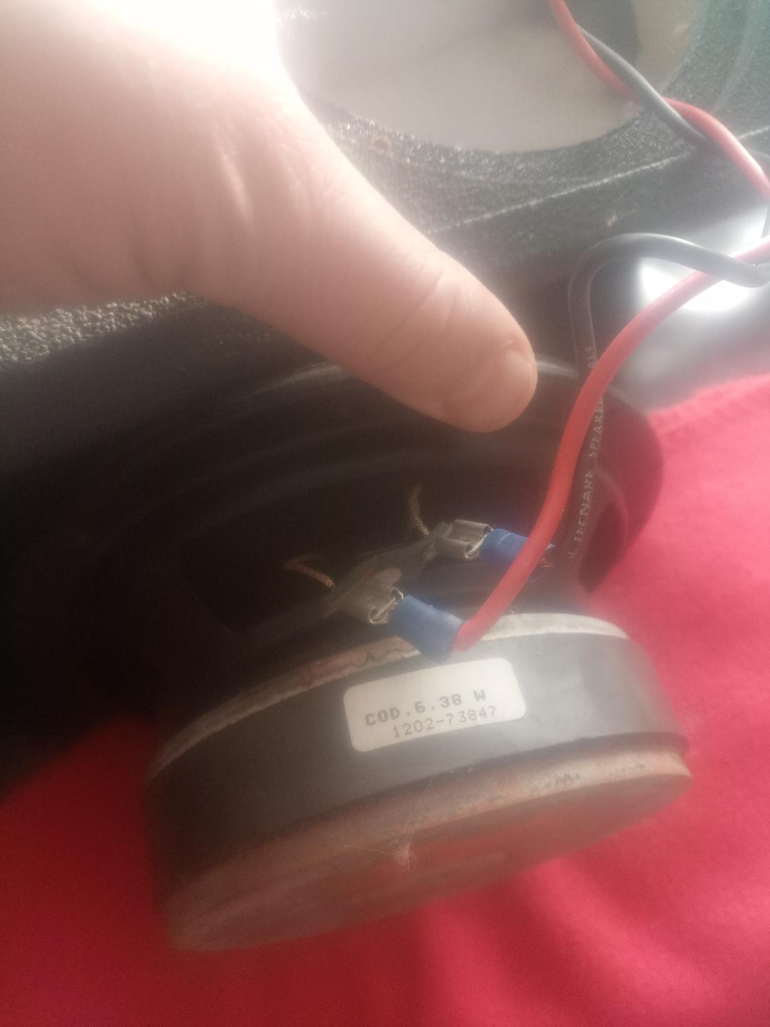

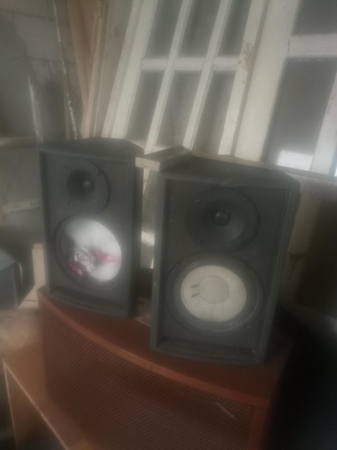

Am primit niste boxe trapezoidale, bass reflex, din lemn stratificat cu 6,5inch+supertweeter(165mm are basul), pe grila era lipita o tablita din aluminiu si scrie Sonivisa, in spate mufe dublate neutrik nl4mpr, au inclusiv flanse pentru stativ.
Eticheta bass: COD.6.38 W, 1202-73847
Pare sa semene cu Ciare: http://oem.ciare.com/en/440/350/prodotti.php

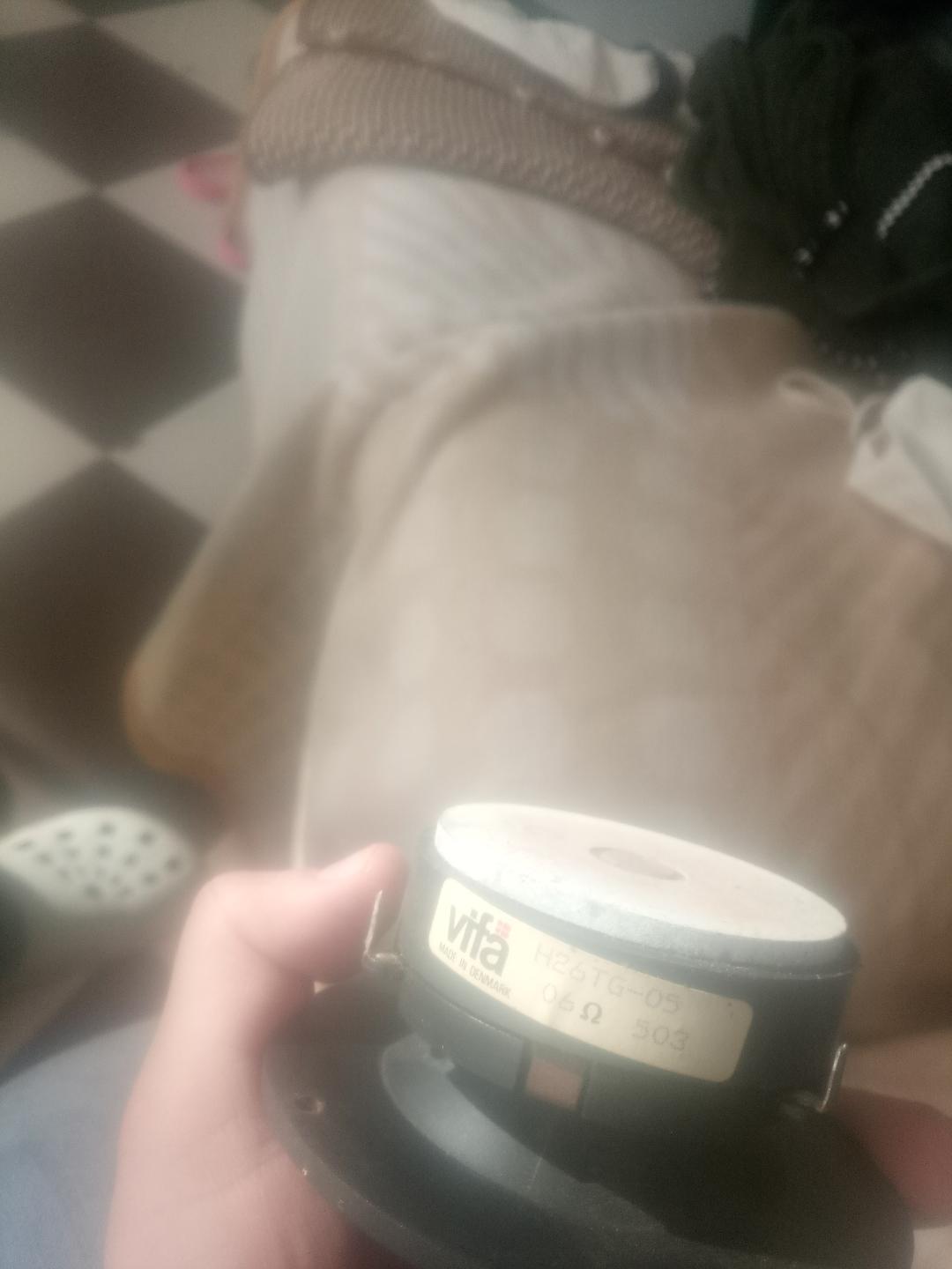

Eticheta inalte: Wifa H26TG-05, 06Ohm 503
Datasheet: https://www.google.ro/url?sa=t&rct=j&q=&esrc=s&source=web&cd=2&cad=rja&uact=8&ved=2ahUKEwiAhKqAgfvgAhWop4sKHaswD9MQFjABegQIBRAC&url=http%3A%2F%2Fwww.madisound.com%2Fpdf%2Fvifa%2Fd26tg-05-06e.pdf&usg=AOvVaw3mOMGGQ8KOxgUQOeUQr3ks

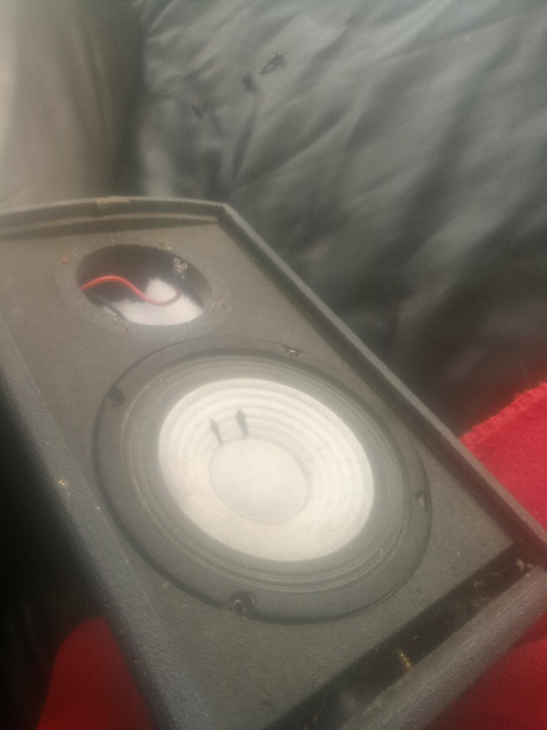

Una dintre boxe a suferit o cazatura(asa le-am primit), si s-a blocat bobina in interfier, rupte 2nituri!
Cu ce difuzoare sa inlocuiesc cele de 6,5inch? Oare merita reparate? Unul merge. Sunt putin oxidate.
As putea pune Faital pro 6FE200?

Am trimis azi un mail la Ciare, adresa luata de pe site-ul lor, sa verific daca chiar difuzorul le apartine. Merita sa incerc.
"Hi,
I need speaker replacement for my Sonivisa F-6S speakers, because one of the speakers where falling down and magnet unglued from assembly.
Inside in the box, there is a label with COD.6.38W and code 1202-73847 – see below picture and I think is speaker produced by Ciare : 6.38W. Can you confirm this? Do you recognize this product?
I’m located in City Timisoara, Romania. How and from where I can buy replacement speakers? I need pair of them. Please support.
Raspunsul lor si de acolo concluzia, se pare ca era un difuzor custom made cu Fs 66Hz - vezi atasament.
"Dear Mr. Topciov,
we can confirm that this is a Ciare speaker, but unfortunately it is very old custom one and we have no way to provide it now because is no longer made for a long time.
We can only suggest to consider the replacement with the model PM160 that is a very similar model, but not identical, attached you find the datasheet.
At the moment we don’t have a distributor in Romania, so for to buy 2 pieces only I suggest to find on the web a reseller that can ship directly to you from Italy.

In concluzie, difuzorul propus de Ciare ca alterativa nu isi merita banii(~350ron buc), pentru ce am eu nevoie.
De reparat cel original care are niturile rupte...nu se merita. Iar unul nou nu se mai fabrica.
Asadar am cautat in oferta de pe poweraudio si nu numai, si chiar daca vroiam un difuzor cu diametrul de 165mm, rotund - cerinta de asamblare, pana la urma am ales Paudio SN6-150MB, care le-am si comandat azi dmineata. Paudio este imbatabil la pret-calitate.
https://www.poweraudio.ro/difuzoare_profesionale/difuzoare_p-audio/difuzor_p-audio_SN6-150MB?filter=13
Va trebui sa modific/adaptez putin cutia, dar pare cel mai potrivit pentru un fullrange, celalalte chiar daca aveau SPL mai mare, il aveau peste 150Hz, iar plotul de impedanta m-a convins; plus ca se potriveste bine cu difuzorul de inalte si filtrul original - se poate vedea mai sus.
Voi incerca sa vad cum merge si ca satelit, probabil trebuie taiat la 120Hz sau chiar mai sus.
