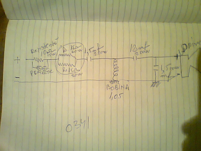

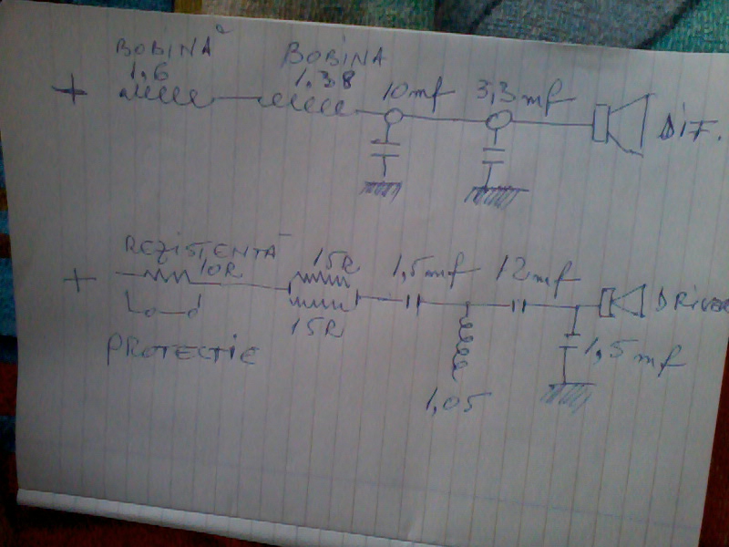

AM IN SATELITI FILTRU DIN IMAGINI. PENTRU A REDUCE VOLUMUL DRIVERULUI CU 3-4 DbTREBUIE SA INLOCUIESC REZISTENTELE INCERCUITE SAU SA FAC UN L. PAD?.VA ROG SA-MI SPUNETI CU CE VALORI SA INLOCUIESC REZISTENTELE INCERCUITE SAU CU CE VALORI DE REZISTENTE SA FAC L.PAD. NU VREAU SA MODIFIC TAIERILE FILTRULUI. INCINTELE SUNA FF BINE INSA CRED CA DACA DIMINUEZ PUTIN DRIVERUL O SA SUNE FF ECHILIBRAT. AM ACELEAS FILTRE PE ALTE BOXE CARE ARE DRIVERUL 108 Db SI SUNA MAI ECHILIBRAT DECAT PE CELE CARE VREAU SA MODIFIC DRIVERUL PE ACESTEA ARE 110 Db .MULTUMESC ANTICIPAT.
